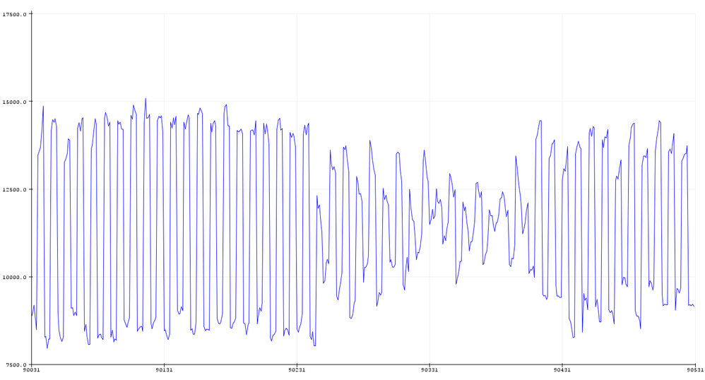

Considering the fact that I can no longer make a difference between waveforms sent at 1kHz (sin and triangular) I am wondering about what I did code wrong in my ADC initialization to mess up my results that much. Below is a 1kHz sin I get for my 200 kHz sampling rate (code below). I use an external Vref MAX6225ACPA to stabilize my reference.

2022-08-19 5:00 PM
EDIT: Something is amiss here. The plot shows about 20 input cycles for 200 samples instead of 1 . Check your conversion frequency.

2022-08-20 8:06 AM
Is the following correct?
If SYSCLK is 480 MHz, Timer 1 is generating an ADC trigger at 240/(19*48) = 250KHz.
ADC prescalar is bit fields 1011 = divide by 256.
Sampling frequency is then 250KHz/256 = 0.976KHz.
Cheers, Hal
2022-08-20 8:20 AM
True, I tried this configuration because I did not understand the LL_GetCommonClock() function return value which did go up when my clock speed was supposed to go down. But using the lowest prescalers values did not really get me satisfying results (still could not differentiate close waveforms like sin and triangular ones and my DC readings remained sin). Do you think there could be a link between my adc accuracy and the ADC clock not respecting a certain value(in the datasheet of the STM32h747 all the parameters of the ADC are described for certain frequencies) ? Should I setup a PLL as an asynchronous clock for ADC and aim for the exact value?

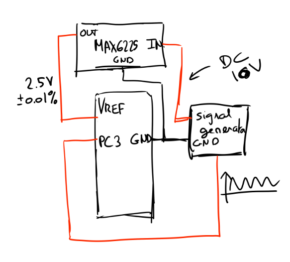

2022-08-20 9:08 AM
This is what my circuit looks like, I am using the STM32h747 within the Arduino Portenta (and the schematics are quite obscure to me https://content.arduino.cc/assets/Schematic%20PDF_SL-ABX00042.pdf?_gl=1*1lvkz5d*_ga*NzIxMjUwMTMuMTYzNzc3Mjc1OA..*_ga_NEXN8H46L5*MTY2MTAxMTI3Ny4yOS4xLjE2NjEwMTEyNzkuNTguMC4w page 2 )
2022-08-20 1:20 PM
The schematic shows PC3 connected to Arduino A3. Couldn't find any other connections.
Suggest eliminate one variable by using Portena built-in references.
Perhaps someone else can spot something.
Cheers, Hal
