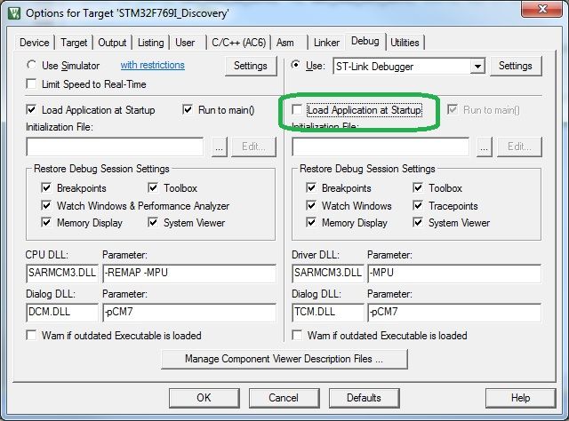

2021-03-11 8:45 AM
In Keil the ULINK2 should be usable, but you'd have to create/build a fake project, set options to NOT download, and then when the debugger opens you can use the SAVE command to pull out the firmware to a .HEX file.

@Community member
Thank you for your interest. I want to know more detail about how to set to options and save command in Keil.

2021-03-11 5:43 PM
Experiment on something non-critical first. Uncheck "Load Application at Startup", automatically turns off "Run to main()"

2021-03-11 8:14 PM
I succeeded in extracting the hex file with the method you told me.
Like that => SAVE C:\TEMP\TEST.hex 0x80000000, 0x8003FFFF
