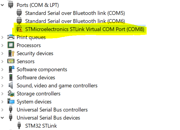

2021-06-02 10:58 AM
The driver installation file is stlink-server 2.0.2. MCU is STM32F405RG.

Ok, but what does Windows flag as the actual reason for the exclamation point? Look at the Properties..
2021-06-02 11:42 AM
Windows flagged it as 'Device cannot start'. So I uninstalled the driver and reinstalled it. The issue persisted.
