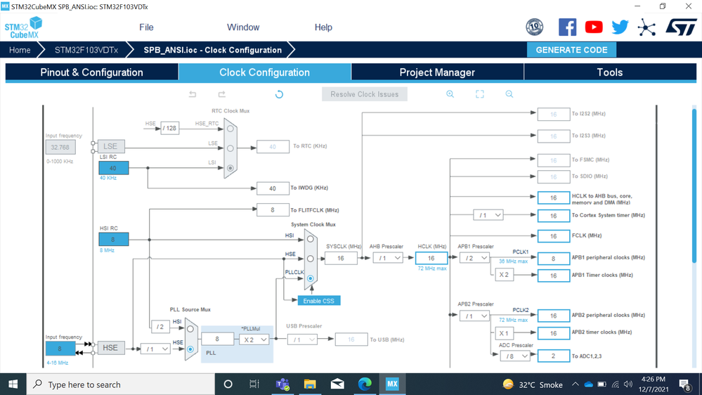

The duration of the timer should be measured as directly as possible, e.g. by switching and measuring on a GPIO.
printf is not suitable for this use case, especially if its output is sent to Linux, which is not an RTOS with a predictable response time.

do you use HSI as clock source?

Thanks for reply. No We are using HSE as clock source

Did you check the frequency coming from HSE using e.g. the pin MCO?
How did you measure the duration of TIM2?

//**********************************In main.c********************************//
int main(void)
HAL_Init();
SystemClock_Config();
MX_USART1_UART_Init();
MX_TIM2_Init();
while(1)
if (TimerOut == 1)
TimerOut = 0;
printf("A\n");
fflush(stdout);

htim2.Init.Prescaler = 24;
htim2.Init.CounterMode = TIM_COUNTERMODE_UP;
htim2.Init.Period = 63999;

}with help of USART1. Printing A on serial terminal when interrupt get generated. timestamp is logged in minicom utility on linux
