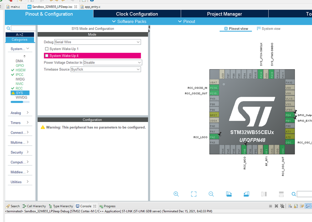

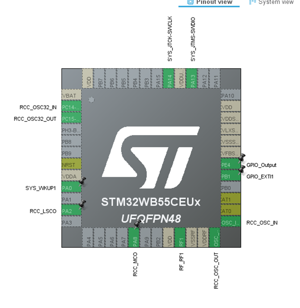

Yes I am trying that and not seeing great results....ie about 5mV read across a 1 ohm resistor (ie 5mA) using an oscilloscope. In .ioc I configured PA0 as SYS_WKUP1. I was hoping to put this on a scope and see it change states when I went into LPSleep....Is this how this pin works?
ioc file...using LSE (32768 hZ) for LPTIM1 and HSE for CPU1 (64MHz)
2021-12-16 11:03 PM
I'm not a WB55 expert. Generally, low power sleep stops only the CPU. This mode is endend by any interrupt (like EXTI, Timer, SysTick,...) or event. In contrast, there are some dedicated WKUP pins which work as inputs and recover from standby and shutdown modes which have lowest power consumption.
