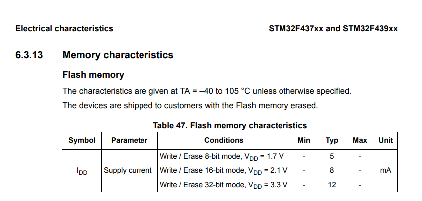

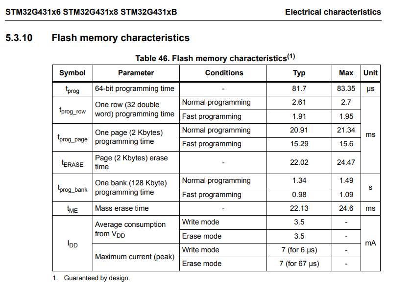

Now, back to EEPROM Emulation, the only Extra consumption versus Normal run mode is the Power consumption of our Flash ( Erase/Write procedure) in a continous way and is about 7mA in G431 and up to 12mA in STM32F429.
