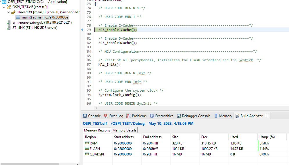

Still I am working in QSPI concept in stm32f746 disco board
I tried to write the data for QSPI flash memory but I can't able to write and read the QSPI flash memory
I have attached my code and snap pls find and give any solution

Erasing the entire memory is probably overkill.
You don't really describe what the issue is. ie your expectation vs what you're seeing.
The code here is very superficial, top level stuff.
Not sure there's a lot of interest in describing and debugging functionality like this.

Hai sir ,
I am using stm32f746 disco board its in build QSPI memory... first i try to write one data to qspi memory but is note store in qspi flash region but is store normal flash region.thats problem i ahve tried all code and tutorial and google but not give better sollution .that my problem
2023-05-10 4:09 AM
my expectation only store the data in qspi memory

Hello @Yugenthar ,
I recommend you to start from an available example.
For that I recommend you to take a look to this QSPI_ReadWrite_IT example running on STM32746G-Discovery board.
This example describes how to erase a part of a QSPI memory, write data in Interrupt mode, read data
in interrupt mode and compare the result in an infinite loop.
So, try to get inspired from the instructions in the readme file.
I hope this help you!
