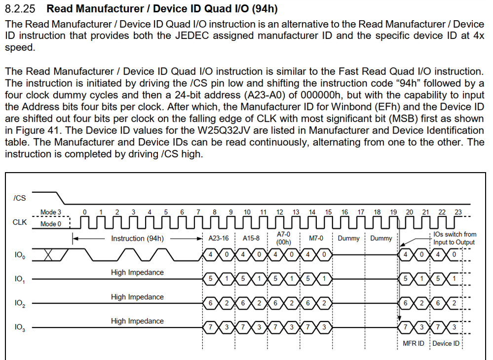

2023-06-05 9:38 PM - edited 2023-11-20 4:15 AM
PROBLEM SOLVED!
Current settings for SPI QUAD I/O.
/* Reading Sequence*/
sCommand.Instruction = 0x94;
sCommand.AddressMode = QSPI_ADDRESS_4_LINES;
sCommand.Address = address;//0x000000
sCommand.NbData = length;
sCommand.DataMode = QSPI_DATA_4_LINES;
sCommand.DummyCycles = 4;
2023-06-01 6:51 AM
From the data sheet, the command 0x90 uses one output line. So,
sCommand.DataMode = QSPI_DATA_1_LINE;
PROBLEM SOLVED!
