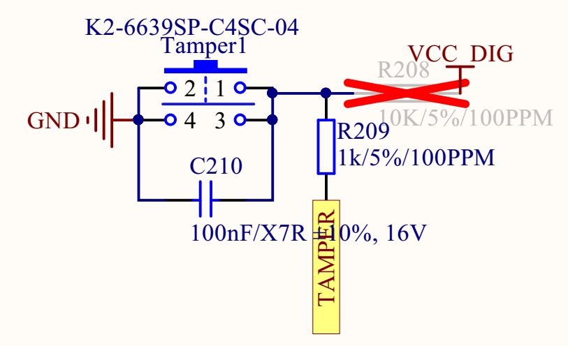

The MCU is stm32l052c8, and the PC13 is used as tamper.
when i pressed the button down,  now tamper occoured ,the interrupt flag doesn't changed .
