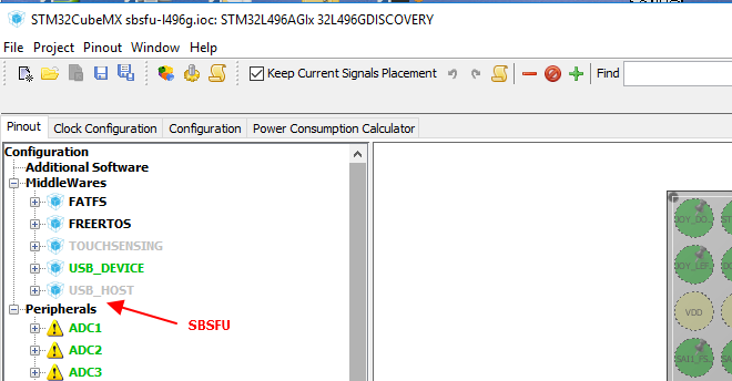

My question is, in future is there a plan to add support for SBSFU to STM32CubeMX, like the image below, to simplify the setup?

Regarding SBSFU support for STM32CubeMX:
I think there are two types of packages required: SBSFU_bootloader and SBSFU_application.
SBSFU_application should be enabled for user applications.
It should update SystemInit() function with appropriate SCB->VTOR value. Currently it is manual process described in Figure 38 of UM2262 document.
It could also maintain slot addresses in linker files.
SBSFU_bootloader should be enabled for user defined SBSFU bootloaders.
For selected project it should add necessary libraries, linker definitions, keys etc.
This could really simplify process of creating own SBSFUs bootloaders.
