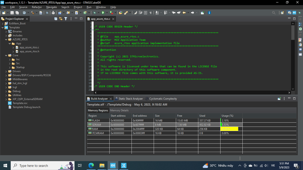

do you want to use sdram to put that image on screen, or use external flash to save it??
i just found a nice example, that can use both external flash and sdram, but it is stm32f7508 dk same as my board, hope it helps you
put the image here and try to compile it
Mula-Gabriel/STM32F7508-DK-LVGL-AzureRtos-Template (github.com)
