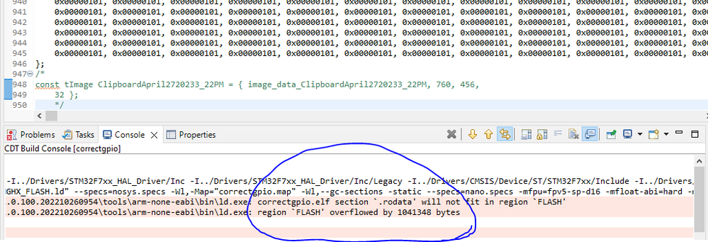

Right now i am working in embedded development platform . So i have one doubt guys.I have using stm32f746-disco board.
I am displaying one image in LCD screen (800x760)so pixel size is incresing.
my code is runing in flash memory
my compiler is show one error "your flash is overflow"
then I have decided move to SDRAM and store my code
But I have not perfect in SDRAM so any one give the sollution any material or tutorial link

From your screenshot: definitely you need some external memory...

When running out of Internal Flash the External QSPI Flash would be where to park large graphic resources. Would need to select an External Loader to download data to it, and then App side code to bring up the pins and memory interface.

It is a low-pin-count external memory. Often an 8-pin device, with 6 pins on the STM32 side for communication.
The STM32F746G-DISCO has a 128-Mbit (16MB) Quad-SPI Flash memory.
I don't recall if it's a Micron or Macronix device, but it should be supported via the BSP code available for the board.
