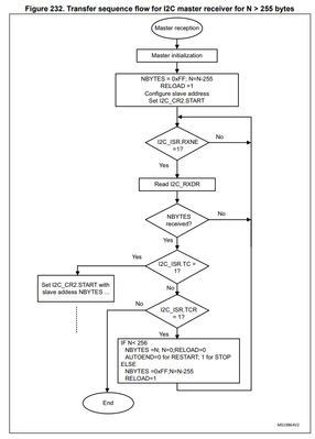

2023-08-01 2:31 AM
Hello @kkazu ,
If you want to receive 2050 bytes of data, please flow this sequence : ( Figure 232. RM0490 )
Foued
