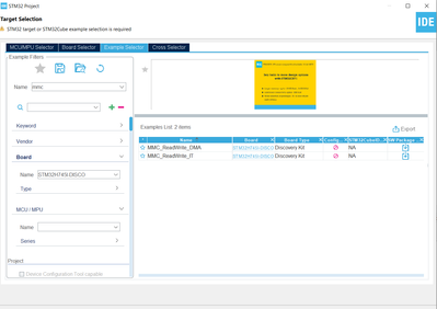

I was referring to the following examples seen in STMcubeIDE
I understand that your code is like a template, I would have to pass it to a project created from 0 by me in stm32cubeIDE, right? because I copied the emmc.c and .h files that you indicate me and if I compile it I get the following message also does not have the .ioc as to see graphically the configuration. error code above (I don't know why I don't see it below)

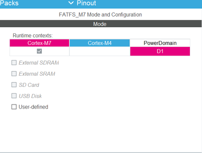

When creating an oriyecto from 0 configuring it as it is in the HTD I missed in fatfs_m7 that I would not know what options to select.
I share the project to see if maybe I missed to configure something before or just the fatfs to be able to pass the emmcc and . h and what you passed me in the main.c and start debugging to understand the steps.
2024-12-02 8:47 AM
There is no available project from scratch. You need to configure your ioc file by following the parameters in these examples.
