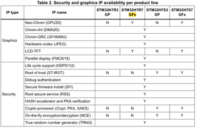

I confirm that. According to the table 2 of the DS14360, All STM32H7R7 are GFx packages:
So, the STM32H7R7A8I6 is UFBGA169 GFx with SMPS.

If STM32H7R7 only comes in GFx packages, why are there two UFBGA169 pinout tables in the datasheet?
The UFBGA169 SMPS is for the STM32H7R3A8I6 that is not GFx as you can see on the same table.
