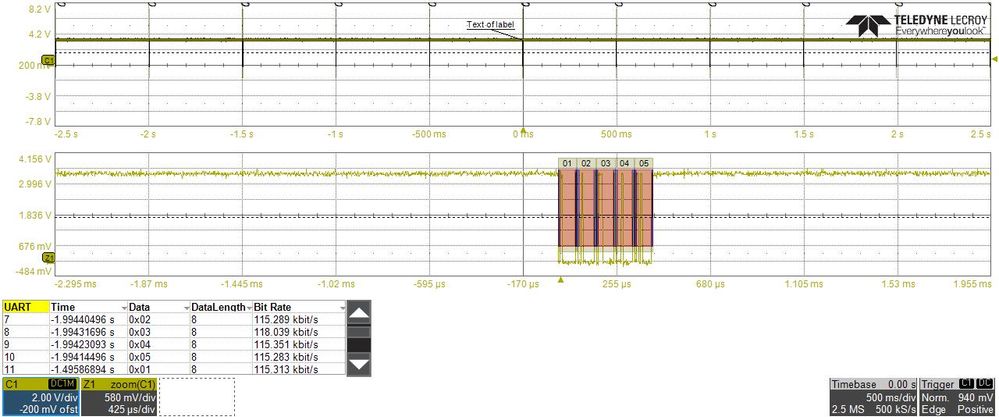

2023-06-06 8:07 AM - edited 2023-11-20 3:53 AM
I join as an attachment a capture using oscilloscope.
C1: Is the USART2 DMA transfer each 500ms (small vertical yellow line each 500ms) corresponding to HAL_UART_Transmit_DMA()
And
Z1: Is zoom window of one vertical yellow line, it shows the bytes array transmitted.
2023-06-06 9:47 PM

2023-06-06 11:15 PM
Hi @mrsmile (Community Member)
I use the code USART_CheK_ST in the archive that I send to you. It uses the Systick Timer and that's the capture I show.
Does it works now for you?
Does it helps?
Thank you for feedback.
romain
2023-06-07 1:00 AM
Thank you so much your response @RomainR. sir, code is working properly sir and Five bytes data send UART_DMA in 500 ms once working good.
