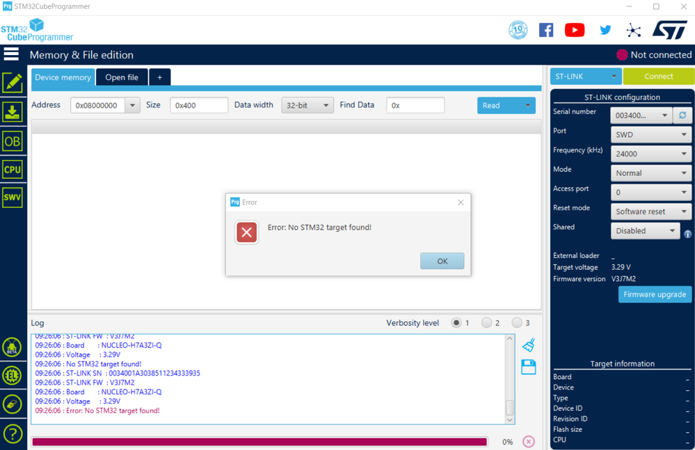

--The first error encounters while trying to connect the board (STM32H7A3ZI-Q) with STM32Cube Programmer at normal mode.

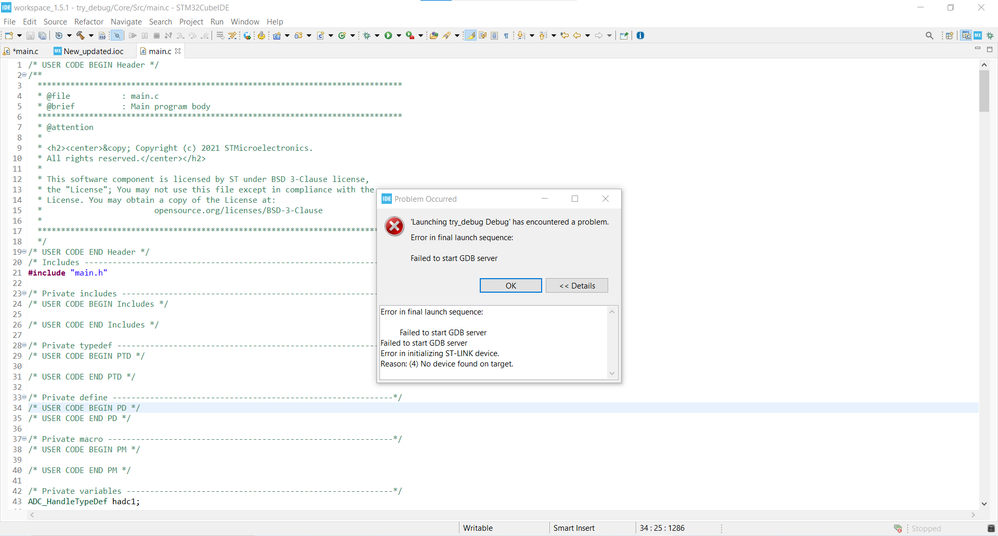

--The second error encounters while trying to upload a code through STM32Cube IDE.

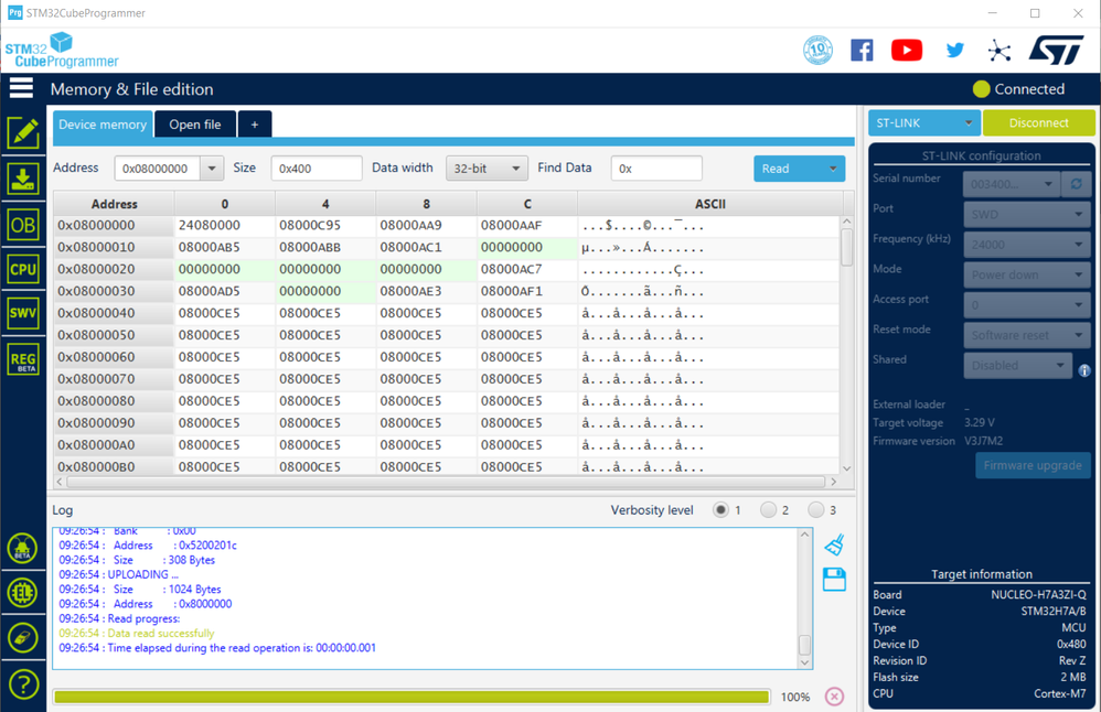

However, when I try to connect the board with STM32Cube Programmer at power down mode, it successfully connect .
Hence, being a naïve in this area, I hope everyone helps me out to find the solutions. Thank you.

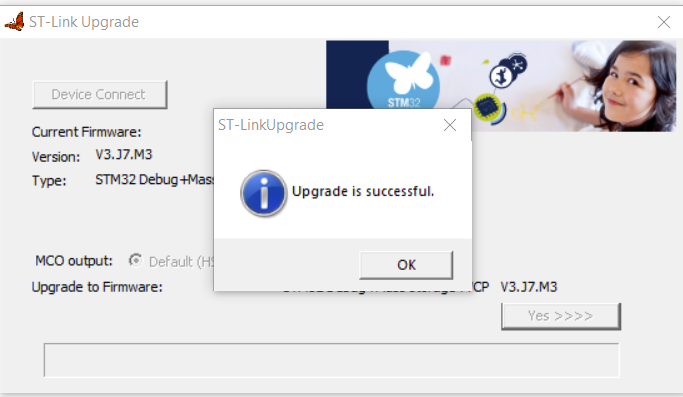

Hello @PWaiba and welcome to the Community,
Your STLink firmware version is an old version.
So, please try to upgrate your STLink firmware. Then keep me informed about your update.

2021-07-29 8:32 PM
Although the upgrade is successful, the error still encounters while uploading the code as cited in the picture.
2021-07-29 8:58 PM
I followed the link and found that the issue was with my power configuration. By following the steps there, my issue is solved. Thank you @Community member .
