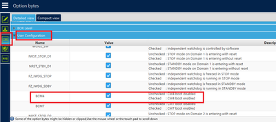

@aradhyab wrote:
Can you please guide me on how to check if the option byte is enabled or disabled?
Using the STM32CubeProgrammer:
BCM4 should be checked as shown in the screenshot.
2026-02-08 8:23 PM
Yes, I undefined dual boot core sequence at both the sides and BCM4 is also checked as shown by your screenshot.

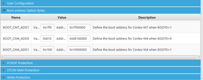

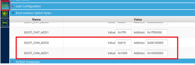

2026-02-13 4:54 AM
Check also if CM4 boot addresses have the following values in the option bytes:
2026-02-17 8:47 PM
I checked the addresses, they are correct.
Is there anything else that needs to be checked?
