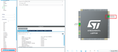

The issue is not clear.
I can set PA11 and PA12 for USB in CubeMx for STM32U595.

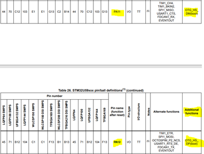

HELLO @Yang Yang
Infact, PA11 and PA12 provide OTG_HS additional functions, and they are not alternate functions:
When you enable the USB_OTG_HS (as done by my college @mƎALLEm ) those Pins are automatically set to OTG_HS additional functions.
Best Regards.
STTwo-32

2024-12-23 5:38 AM
@Yang Yang wrote:
Yes, actually I found that OTG_HS_DP is additional function. But I don't know how to configure it. In cubemx generated framework is that done by MX_USB_OTG_HS_PCD_Init()?
You can use CubeMx and configure USB pins as I showed above.

Hello @Yang Yang
It is not required to add the code to configure the USB DP/DM as those pins are directly connected to USB as soon as this peripheral is enabled.
Best Regards.
STTwo-32

2024-12-23 5:53 AM
The pins config is not generated. These pins are used directly by the USB as soon as the USB is enabled.
2024-12-23 5:59 AM - edited 2024-12-23 5:59 AM
PA12 is internally set to OTG_HS_DP as soon as you Enable your USB_OTG as i said on my second comment (no code needed to do that).
Best Regards.
STTwo-32
