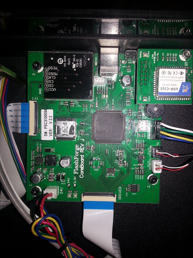

I purchased a 3d Printer on clearance with a tag that says Does not Start up.  No warranty.  I was ok with that.  As I'm a developer and a hardware hacker I knew I was buying a project not a printer.  I have experience with Atmel, wrote my own firmware for a Cricut cutting machine, so I'm comfortable here.
The situation I believe is that the store had upgraded the firmware on this machine but used the wrong firmware.  There is much discussion about this situation on the internet from this particular brand of printers. Overall, the quality of the printer is great.  So now the problem.
The images show that the MCU is an STM32F407ZTG6.  I can see clearly that it has SWD header yay.  So I connected the STLink board from my Nucleo to it, removing the jumpers so that I can use it to program an external device, connected the 3.3v power pad on the 3D Printer's board to the 3v3 header on the Nucleo, and I can tell the board has power.  However, STLink does not see the target.  Anyone have some ideas to help revive this guy?

Posted on December 19, 2016 at 17:22
One part of me suspected the disabling of the SWD interface, but the other says why would they put a header on the board clearly marked as SWD if they disabled it...
Here is what I have thus far:
Connected STLink board from the NucleoF411 to the printer's motherboard.
VDD, SWCLK, SWIO, GND  > STM32F407 pins. Remove jumpers on STLink to indicate external target.
There is a pad labeled 3v3 on the target board. Connected that to 3v3 out from nucleo.
Powered STLink board from USB port
Attempt connection from STLINK, no go.  At this point STLink goes legs up and have to remove USB and reconnect.  Attempted connect under reset , same result.
I ordered a new chip from Mouser.  Looks like USPS ate it.  Have to get another
I'm seriously considering just getting the ST 3d printer board   Since this printer is all closed source anyway..
Posted on December 19, 2016 at 17:28
You shouldn't need to connect VDD, especially if they differ (ie 3V vs 3.3V), the stand-alone ST-LINK pod needs a Target Voltage for it's buffers, the one on the NUCLEO/DISCO board lacks those, and connects directly to the CPU.
Other thoughts would be to see if the chip is alive, and if the System Loader works. Pulling BOOT0 high might permit connectivity via the DFU mode (comes up on the PC as an STM32 DFU device), or connectivity via USART1, or perhaps USART3, where an 0x7F byte sent at 9600 8E1 (Even Parity) should respond with an 0x79 byte. On the power side one could look at the state of the NRST pin and for 1.25V on the VCAP1/VCAP2 pins.

Posted on December 20, 2016 at 01:22
All the led's come on the board and the driver board   But no chirp from windows.  What's your revision code on the mainboard?
Posted on December 20, 2016 at 01:29
It appears to be the same as yours FlashForge CoreBoard REV J.  See attached photo.
