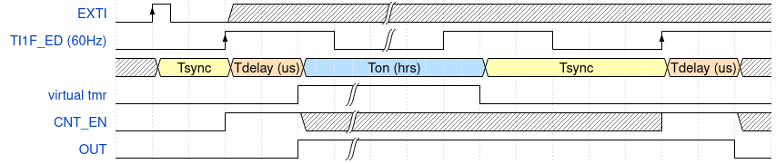

A little hard to decipher the behavior you want here. Perhaps a diagram would help.
You want CH2 to go high a set period of time after CH1 goes high? And then an indeterminate amount of time later, you want CH2 to go low after the same period of time as before after CH1 goes low?

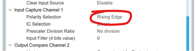

IC polarity is selectable in CubeMX.

Yes, it's hard to explain, so I found a diagram tool and came up with this:
On the other issue, since I'm not using input compare, just slave mode with trigger, there is no control over the edge polarity in cube mx, at least that I could find. I'm not sure if there would be a better configuration for this process, as I've mostly use timers for very simple delays, etc.
