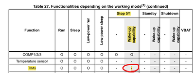

> STM32G0 wake up by timer external trigger

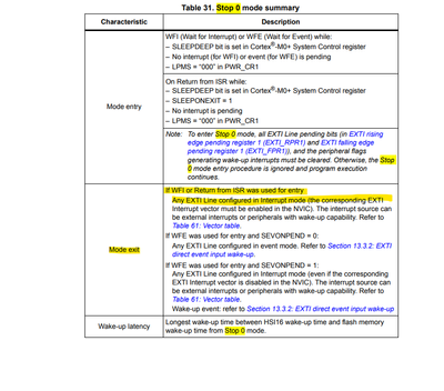

TIMx has no wake-up capability from STOP mode, ETR or otherwise.
2025-05-23 12:56 AM
Thanks for the quick response TDK. What is the name of the documentation file you took this table from? So what are the other possibilities of waking this processor from STOP mode by an external signal?
2025-05-23 12:58 AM
OK, i see its just RM0444.
