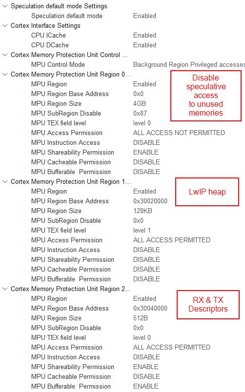

Question: according to the manual for "H" series I need to create 2 sections one for "LWIP heap" and the other for
"RX & TX Descriptors". But, I can't find custom sections for "LWIP heap" and "RX & TX Descriptors" in the .ld files in the examples!?
But, there are screenshots of how to customize these zones in the CubeIDE GUI, see screan.
