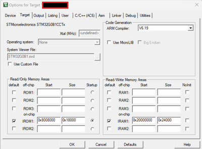

In the main application, I have modified the application offset by adjusting the vector table offset and updating the linker settings as follows:

3.b. I changed the linker settings (under "Options for Target...") by updating the ROM1 start address to 0x08008000, as shown below:
I have verified through the debugger that the program counter (PC) successfully jumps to the main application’s main() function, and SCB->VTOR is set to the 0x08008000 address.
