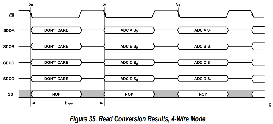

I am currently developing an MCU based radar. I tried to implement 4-channel ADC Sampling 1MSPS based on STM32H743, but the results were not good. There are many problems, but the biggest problem is the sampling rate, so to solve this, we plan to use an external high-speed ADC chip (AD7383-4). As you all know, the STM32H7 series supports QuadSPI. Of course, there are mainly examples related to Memory. Some engineers say that you can set it to indirect mode and do it. (https://stackoverflow.com/questions/73855861/qspi-connection-on-stm32-microcontrollers-with-other-pe...). Another engineer said that STM32 Quad SPI is difficult to use because it is for memory and data is loaded alternately on the Quad SPI data line. This part seems to be somewhat limited to memory.
Do you know if there is a way to simultaneously receive 4 channel ADC data at 4MSPS using quad SPI on STM32H7?

It is not so difficult to use QuadSPI in STM32H743. It should be easier to use indirect mode to interface with AD7383-4 (datasheet: AD7383-4/AD7384-4 (Rev. 0) (analog.com))
S0: indirect write to trigger ADC conversion, no instruction/address/Alt./Data phase, 1-cycle dummy may be tried.
S1~S16: indirect read to read back ADC conversion results, 16-bit resolution assumed, no instruction/address/Alt./Dummy phase, 1-byte data to be used for each cycle but only one nibble to use. re-assemble is needed to recover 4-channel data.
Besides, better to use DDR mode instead of SDR, for each cycle, so as to save time and improve efficiency.
