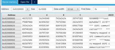

The MX25LM51245G_PageProgram() API returns success message but I am unable to see the updated string in the external memory location through the memory browser window in CubeIDE. Also, the MX25LM51245G_BlockErase() and MX25LM51245G_ChipErase() does send the success response, but not clearing the specified memory block.
Is there something that I am missing here?

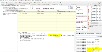

I got the hardfault handler when I set the memory mapped mode and tried to write into external flash using memcpy() API. I have not used that approach in my current application and I am trying to write into memory using the MX25LM51245G_PageProgram() API.
The size of the external flash is 64MB, 1024 sectors of 64kb sized blocks.

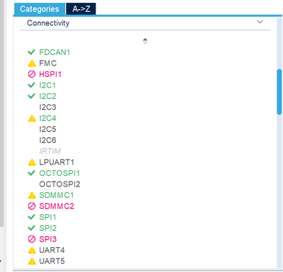

No XSPI option here to select:
KDJEM.1
Hello @RiverDi_user ,
The STM32U5A9 supports three interfaces (OCTOSPI1, OCTOSPI2 and HSPI1).
The STM32U5 HAL  delivers both stm32u5xx_hal_ospi.c/.h and stm32u5xx_hal_xspi.c/.h files for customers.
- stm32u5xx_hal_ospi.c/.h: for OCTOSPI1 and OCTOSPI2
- stm32u5xx_hal_xspi.c/.h: for HSPI1, OCTOSPI1 and OCTOSPI2
When using STM32CubeMx for generation code:
* stm32u5xx_hal_ospi.c is used when OCTOSPI instance is chosen
* stm32u5xx_hal_xspi.c is used when HSPI instance is chosen
 >but that throws lots of error due to settings like (error: 'XSPI_HandleTypeDef' undeclared), USE_HAL_XSPI_REGISTER_CALLBACKS etc, and it doesn't compile as expected.
->If you want to use OCTOSPI interface, you can used OSPI_HandleTypeDef and  USE_HAL_OSPI_REGISTER_CALLBACKS instead of XSPI_HandleTypeDef and USE_HAL_XSPI_REGISTER_CALLBACKS.
I recommend you to take a look at AN5050  this application note explains the difference between Octo-SPI, Hexadeca-SPI and XSPI interfaces in STM32 MCUs. Also this application note provides many examples in section 7 OCTOSPI application examples can help you.

Hello @KDJEM.1,
I had a look at the document link you shared and tried with device size 26 and Refreshrate as 0 (as per doc) as I am using MX25LM51245G. But I still get the same results. One thing that I noticed is, when I try to write the data into external memory and tried to read it, I could partially read/write data into the memory and I see only 20 bytes of data being written and read when I browse through the memory. But when I read the memory from STM32QubeProgrammer, I could read the whole string that I have written in the location.
Also, when I use HAL_OSPI_Command_IT() API the application hardfaults in HAL_OSPI_IRQHandler(). (I am not sure why)
Browsing through STM32QubeIDE debugger:
Any idea why its happening like this?
Here is my updated code:
