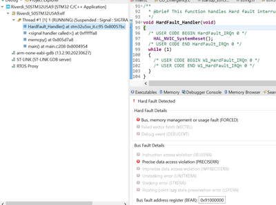

I receive a hardfault handler error when I call the memcpy(). Can you please let me know what am I doing wrong here?

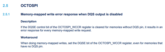

Could you please check if DQSE bit is set or not?
Because it is mentioned in the errata sheet, when doing memory-mapped writes it is recommended to set the DQSE bit of the OCTOSPI_WCCR register, even for memories that have no DQS pin.
Thank you.

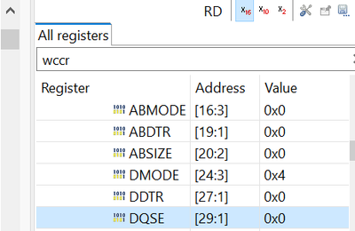

Its set as 0, but I am unable to set to 0x1
