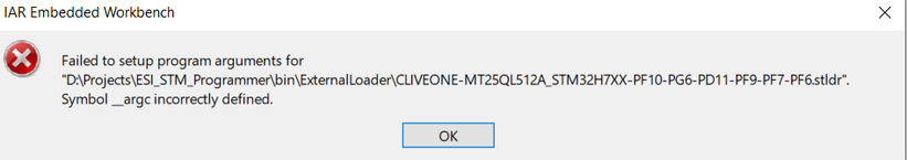

Getting above error if trying to debug and download code in IAR. is there any specific setting required for loader or linker configuration.
Controller : STM32H745XI
External flash : MTQL512ABB
Please find linker details below:

Hello @Gajanan
Which IAR version are you using?
Make sure to use the latest IAR version as it contains limitations fixes and enhancement.
2024-08-27 10:59 AM
As I see I think you are using a custom loader. Are you sure about its implementation? The error doesn't seem to be linked to the linker but to the loader itself.
Try to test it with STM32CubeProgrammer using this method:
