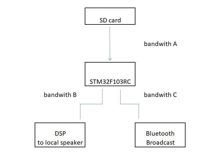

I have a project that is a series speakers.
There are 2 speakers master speaker (MS) and slave Speaker (SS)
I want to design the MS as following function.
1) use phone as controller through Bluetooth
2) MS with SD card a list of song stored in the SD card
3) by Phone App. I can select Sone A to play on MS
at the same time select Sone B to send it to SS by Bluetooth.
both Song A and B are stored in the SD card.
(The songs are special and not stored in the Phone)
Thank you!
the Key question is
can STM32F103RC read Sone A from SD to send to DSP to play
and Read Song B to send to Bluetooth module to broadcast at the same time ?

Hi, Clive:
by theory if the bandwidth A > B+C
it could be possible, right?
I believe the audio stream is not so fast. it maybe Ok about 30Kbyte/s
even there is some decoding function in the STM32. it still enough power to deal.
Thank you for help

Probably want an F103VE or F103ZE with an SDIO interface to the CARD, you can certainly read two file streams concurrently with SPI connectivity, but it is going to be much slower, the question really comes down to having sufficient bandwidth to do the tasks you want.
