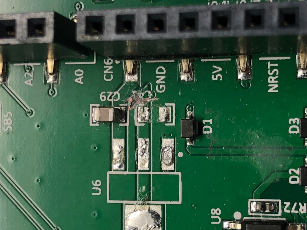

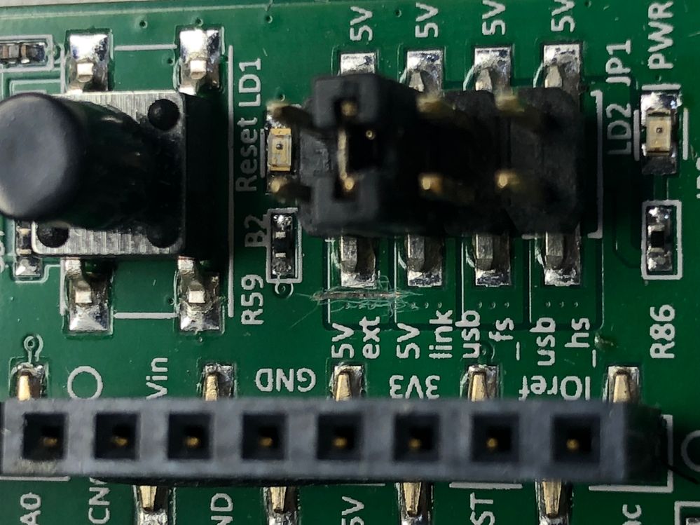

2018-11-16 1:16 PM
Not sure if anyone else has run into my issue, but this seemed like a good place to post it since it's somewhat related and I landed here while looking for answers.
I was having very similar problems using the "VIN" pin on the Arduino header. I have two of these STM32F746G-Disco boards and they both had the same problem... The V-Out pin on U6 (5V reg) was shorted directly to ground (in the PCB, even after removing components).
A little board modification to cut the connection at both ends and route a new wire over to the jumper header and now they both work perfectly.
Maybe there's something else I missed somewhere and someone here can point that out, but this did the trick for me. I hope it can help someone else =)
