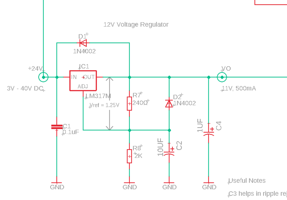

I'm trying to power a STM32F746G-DISCO board from the CN6 VIN pin.
I have a voltage regulator that output 11VDC current.
The screen turns on but the program never start and LD6 and LD3 become red after a few seconds.
I measured the current between GND and VIN, it's 11VDC , during few seconds, the it go down to 3.3V.
I measured the VO from the voltage regulator without connecting it to the board, and it's 11VDC stable.
The jumper is on V5ext, as explained in the documentation.
What is wrong with that setup ?

Have calculated have much your design dissipates power? This may be an overheat problem too. (40V-11V)/0.5A is not a little amount of heat. Use 5V switcher, it works, they come in to220 package.

@Community member Everything share the same ground, which is the 24VDC power supply ground. So I connected the DISCO GND to the same ground. I didn't try to power the DISCO VIN directly to a bench supply. I will try it (will need to buy a bench supply :)) The shield contains other things, mainly external connectors (buttons, relay, RX/TX interfaces...)
@LMI2 I use a 24VDC/3A power supply but the voltage regulator should output only 500mA. I will try with 5V switcher. Does something like that will work ? http://www.ti.com/lit/ds/symlink/lm2594.pdf . Thanks.

Yes, lm2594 would probably work but I would use these: https://www.digikey.fi/product-detail/en/recom-power/R-78E5.0-0.5/945-1648-5-ND/2834904. They are not IKEA style. Digikey has several similar models also for diffident voltages. Like Clive said, you really should check currents and power loss. The regulator I gave has 0.5A limit.

You can't use the linear reg... and you need capacity.
" 317 is outputting 500mA," it must be burning.... 24V - 12 = 12V... @0.5A = 6 Watts
@LMI2 has shown you the DC-DC converters, they work very well.
Its advised to use inductors in series to dissipate the switching noise, refer to the datasheet.
then your board will run a bit warm.... not blazing.....
then add minimum 1000uF before the reg and something 10-100uF after.
Low ESR caps are preferred, but not always necessary.
