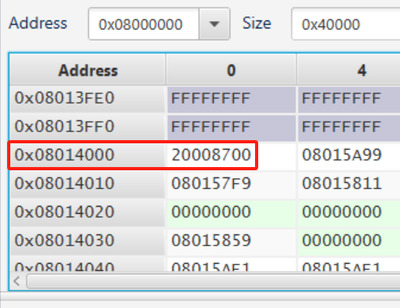

2025-01-14 9:14 AM
My previous test was invalid.
I checked the device memory in CubeProgrammer, the value of the first address of App was already set by the linker to 0x08008700 in the bin file according to the settings in .LD file.
