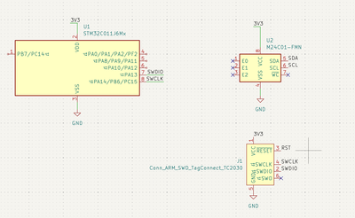

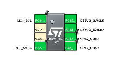

2025-12-24 9:08 PM
Hey Andrew,
Thanks for your help with the diagram.
I created something in the CubeMX, can you just check if the assigned pins are good?
And as schematic is concerned, I am planning to keep three components on the PCB for easy debug. Do you feel I am going in a good direction?
I am eagerly waiting for your feedback.
