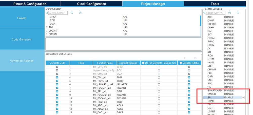

AVasi.11
Associate II
Writing software on the STM is like solving quests all the time. Unfortunately, in my experience there are more than TI or Microchip, for example. Lots of bugs even in rm that haven't been fixed for years
I managed to solve this quest in 3 minutes, I guessed that there should be settings in the cube
AVasi.11
Associate II
AScha.3
Super User
as shown by AVasi , you can set REGISTER_CALLBACKS in Cube ;
you have to update Cube/IDE to newer version (IDE 1.10 or newer), to get this callback settings.
look, maybe you have it and just didnt know... or update.
_richard
Associate III
yes, you are right, the cubmx configuration is now possible, even as it is not obvious where to find it.
