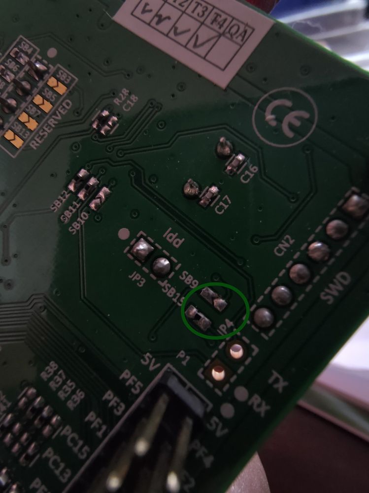

Make sure that any Solder Bridges (SB) that provide for connectivity for SWO/PB3 pin are actually make. (SB9)
You also need to make sure both ends understand how fast the processor is running, vs the SWCLK, otherwise the baud rate setting will be wrong and you'll get no data.

I don't think that solder at SB9 could joint them together properly. Should I have to short them maually?
and for baud rate and system clock did u mean to keep both frequency at same level (MCU and St link)?

You need to bridge SB9
The debugger needs to know what speed the core's running, a mismatch in settings/reality results in "not working"

merhaba, probleminizi çözdünüz mü? Çözdüysen lehim köprüsü ne anlama geliyor ve nasıl yaptın, lütfen bana açıklar mısın? SB9 pininin ortası boş, oraya biraz lehim mi uygulayalım?
2022-06-21 3:05 PM
hello, did you solve your problem? If you solved it, what does the solder bridge mean and how did you do it, could you please explain to me? The middle of the sb9 pin is empty, do we just apply a little solder there?
2022-06-21 3:08 PM
If it's not bridged it surely won't work..
Bridge SB9 with a blob of solder, small wire, or zero-ohm "resistor"
