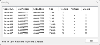

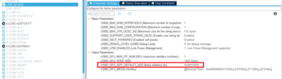

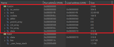

We try to set USBD_DFU_APP_DEFAULT_ADD to 0x08010000 based on the following information.
(1).Build Analyzer
(2).Flash Mapping

Interesting! to conclude, USBD_DFU_APP_DEFAULT_ADD should be set to the start address of your user application in Flash : 0x08010000 in your case.
