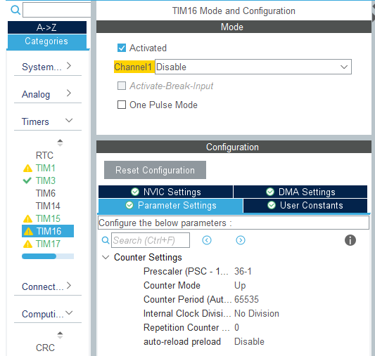

I learned that, I should create a tim channel as a timer with my 48MHZ cpu because we need it for decoding the signal. I'm using PB8 GPIO port as RF receiver and as I learned from the datasheet I need to use TIM16 channel for the PB8 port.
This is the TIM16 settings and as I learned from different projects, I need to define Prescaler (PSC - 16 bits value) and Counter Period (AutoReload Register - 16 bits value ). But I don't know why we need these values and which values should I use?

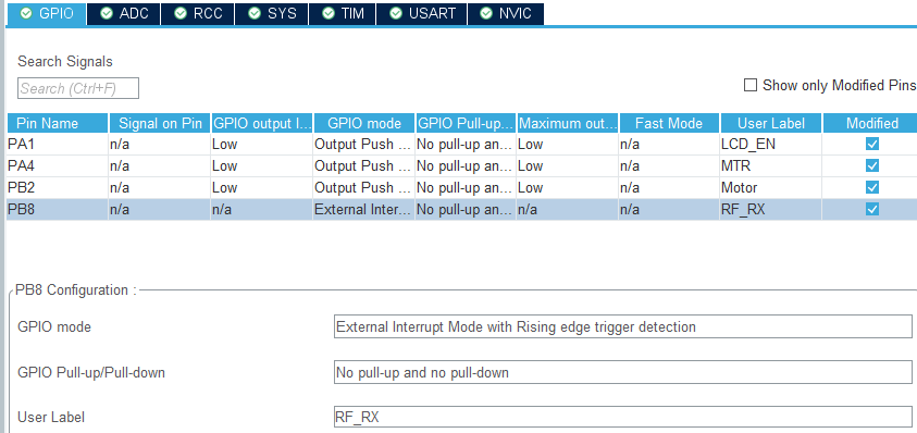

Also I configured the RF receiver GPIO mode as Rising/Falling edge trigger detection to dect low and high signals. Also I selected the No pull-up and no pull-down.

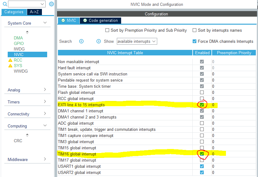

I enabled NVIC for EXTI line and Tim16: (I'm not sure but I think, we have to enable EXTI line to receive the RF signals as callback)
