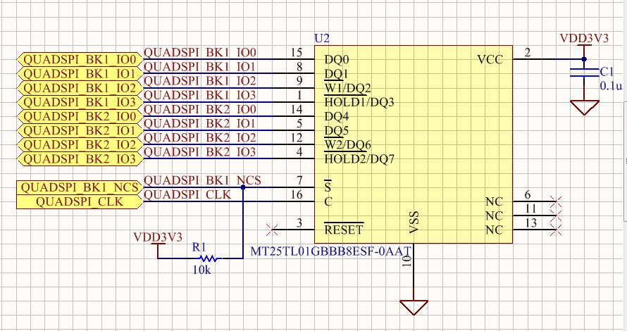

These is a 1Gb NOR FLASH with 2 die structure(MT25TL01GBBB8ESF-0AAT).
It request 8 IOs so that I connect both BK1 and BK2 of H7 MCU.
This above connection correct?

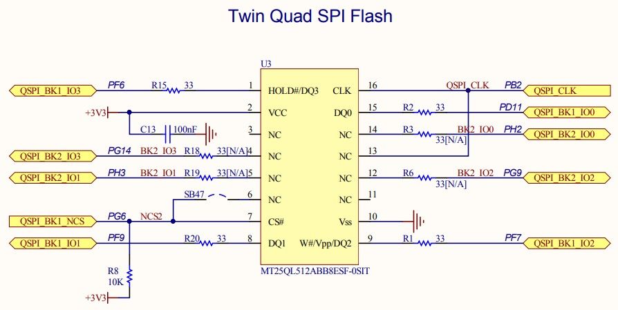

Depend on the dual-die configuration involved. The STM32H747I-DISCO provides connectivity to pin 6 and 13, and foot-prints to place one or two IC
https://www.micron.com/products/nor-flash/serial-nor-flash/part-catalog/mt25tl01gbbb8esf-0aat
The series resistors are there to suppress the ringing/reflections on short traces at high rates
