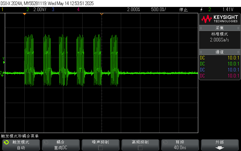

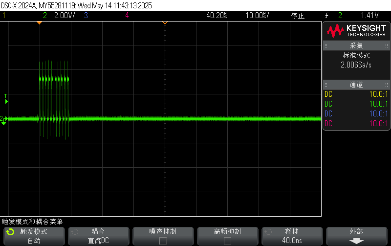

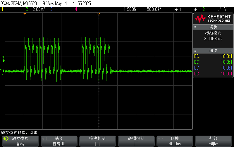

2025-05-13 6:53 PM - edited 2025-05-13 10:04 PM
Just now I tried again to send 4bytes under 1MHz, 10MHz and 40MHz octospi clock,
octospi under dma normal works well.
If change to dma circular, (see the pics)
1MHz clock: works just like dma normal, data is transmitted just once.
10MHz clock: Command sent once, followed by sending data twice.
40MHz clock: Command sent once, followed by sending data 6 times.
Something weird:
1. there is some obvious delay during dma return to the head.
2. DMA stops after 2~2.5uS under 10MHz and 40MHz.
Could you share your test code under dma circular?
