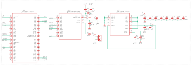

I'm using an ST-Link V2 connected to a custom board via SWD. This is my first custom STM32 design, and here is the schematic:
I have no idea where the issue might be. Any help would be greatly appreciated!

Schematic looks okay.
If you're using a knock-off programmer, note that it might just not work, especially with STM32CubeIDE. Use STM32CubeProgrammer until you can "connect" successfully--it is typically more robust.

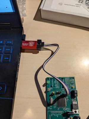

2025-02-24 12:40 PM
This is the st-link that I am using and how it is wired:
I'm unable to find the setting you mentioned.
Could you please provide more details?

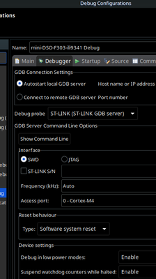

in Cubeprogrammer:
reset mode -> software
in IDE -> debug configuration -> same...

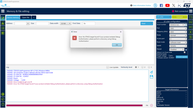

2025-02-25 5:31 AM
So show, what cubeProgrammer is telling ->
2025-02-25 5:35 AM

2025-02-27 10:01 AM
@MarktenKlooster wrote:There was probably something wrong with the ST-Link
It was not a genuine ST-Link:
