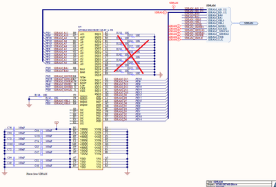

Thank you so much. We ordered STM32H745IITX microcontroller We have STM32H745I-DISCO Board in that can we try to configure SDRAM as an external memory.
If yes, please provide steps how to configure SDRAM in STM32H745I-DISCO Board.
Best Regards,
Gagan Gowda
2024-03-26 12:03 AM - edited 2024-03-26 12:03 AM
As stated before, STM32H745IITX (LQFP176 package) can support only SDRAM up to 16-bit.
Regarding your second question, the SDRAM driver of this board (BSP) is already available from here. But again only SDRAM in 16-bit mode is available with this board:

1. Can you provide steps for STM32H745I-DISCO Board also how to create a project for SDRAM configuration in STMCUBE_IDE.
2. Why SDRAM cannot be configure with STM32H745ZIT6 (LQFP144 package)? Can you provide the reason?
Best Regards,
Gagan Gowda
2024-03-26 12:31 AM
Use CubeMx and try to follow the parameters already available in the BSP.
Already answered that question:
