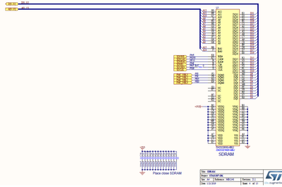

If you want to start with an existing board you can purchase STM32H747-DISCO board.
It has already a hardwired 32-bit SDRAM.
Schematics from here.
Board's user manual and related documentation from here
SDRAM driver (BSP) from here.
