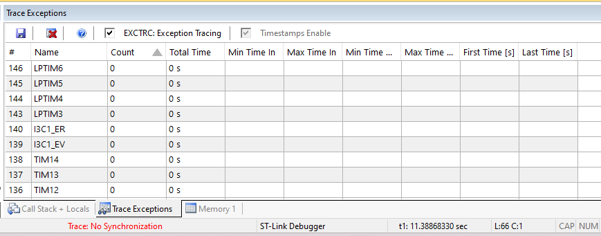

When I enable the "Trace Exceptions" function to trace all exceptions, it always show "No synchronization" in red below. And no exception can be seen from the table.

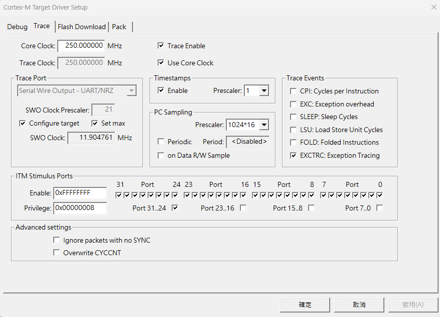

I also uploaded the trace clock settings as below. I guess that I may config wrong track clock.
Is there any suggestions you can provide to me? Thanks.

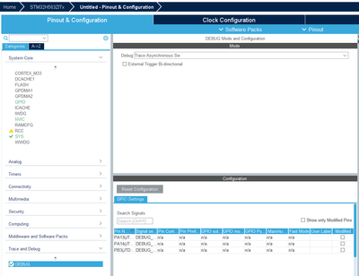

In STM32CubeMX:
Select "Trace Asynchronous Sw" in Debug selection box as shown :
Hope it helps!
Foued
