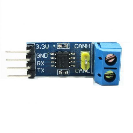

Recently I bought a CAN Transceiver(SN65HVD230 CAN Board Network Transceiver Evaluation Development Module) to convert CAN_RX, CAN_RX signals into CAN_H, CAN_L from a STM32L476RG Nucleo board.
How can I check this Transceiver, whether it is working or not? Which mode I should use(eg: Loopback, Normal.. etc)?

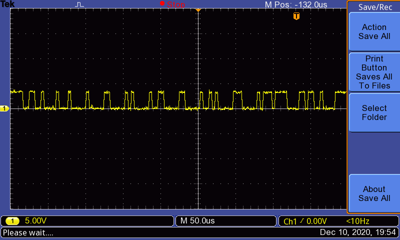

I tried to connect the CAN_TX,RX terminal directly to Transceiver input and checked the CAN_H,L terminal by using a DSO. I am not getting the differential signal as output. When I select Loopback mode,I am able to see the signle ended output through the DSO. I have added the signal image along with this.

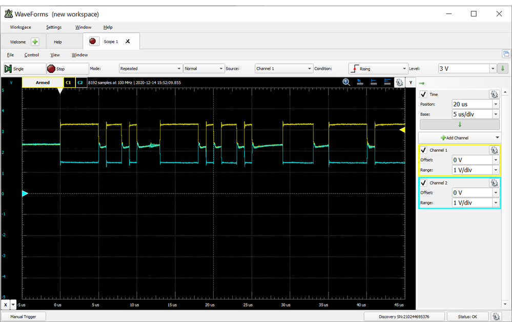

2020-12-14 7:06 AM
There should be a terminating R on the CAN bus side. For testing, you may set all "Basic Parameters" to disable or like that:
and you should see the waveforms:
I'm using MCP2551 though.

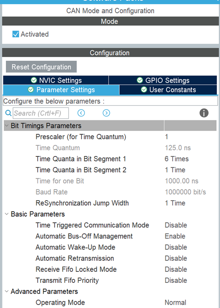

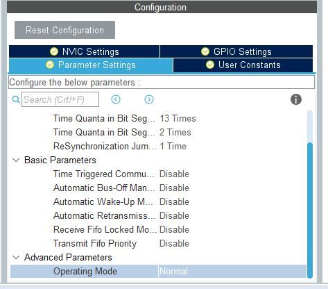

I have added my code and BIT timing parameter as follows as follows.
