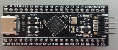

which board ? this:
(on one of mine the 32k crystal was damaged ! )
2023-10-03 1:12 AM
Yes, mine is same
2023-10-03 1:34 AM
just check: is the board clean? any flux remains around the 32k crystal + caps is a no go.
if not sure, clean (isopropanol or aceton) .
