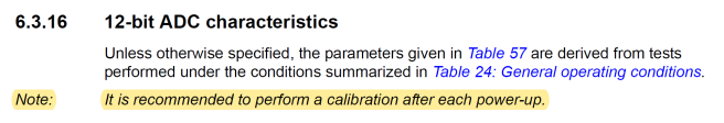

thank you for you reply, but i found in the datasheet :how can i perform a calibration ?
thanks
