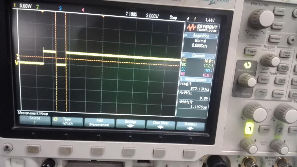

in our project 16MHz is system clock so if 1 instruction per clock cycle then 1/16MHz = 0.000000625 i.e 625ns. we are calculating time duration by using following code. as per above calculation 0.000000625 * 240 = 150us but we are getting 74us on scope. please help me on this
HAL_GPIO_WritePin(BRE_EN_GPIO_Port, BRE_EN_Pin, GPIO_PIN_SET);
for (i =0; i < 240; i++);
HAL_GPIO_WritePin(BRE_EN_GPIO_Port, BRE_EN_Pin, GPIO_PIN_RESET);

2021-12-17 3:03 AM
we tried method you have suggested but getting 1.1876 us time with nop operation. without nop operations it was 560ns

Do the math once more... ;) The period of 16 MHz clock is 62,5 ns and 240 cycles will take 15 us. On ARM the fastest possible loop consists of SUB and BNE instructions and will take at least 2 cycles. Therefore your loop will take at least 30 us.
You don't need NOPs there, just define the variable i with a volatile type qualifier.
