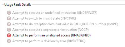

I have a board with a STM32H730 chip, my RAM is configured as not cacheable and instruction access disabled,as performance decreases a lot otherwise, but now i'm getting a hardfault after drawCachedAreas(); is executed,
As i can't see what that function is doing, i thought that mayb someone could help me.
If someone is invested enough here is my MPU config

I am no expert on cache but it says it is not aligned.

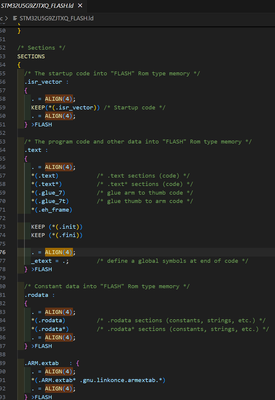

In the linker script, do you align your sections like we do :

Yes!
I also suspected it was an alignment problem, but I have tried different alignments and none have worked, so I came back to the one the .ioc generates for touchgfx,
What makes it hard to debug, is the fact that I have no clue of what Application::drawCachedAreas() does, since it is already compiled in the touchgfx library.
I know the problem isn't the function itself, but rather my MPU_Configuration, but i can't know where is faulting, so I lack a starting point.
The problem has been transfered to some colleagues now, and they are trying things, but we could appreciate if you could share some light into what the function does, beyond what the name tells us.
