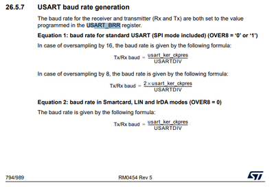

The USART baud rate register (USART_BRR) tells you the division factor that the baud rate generator applies to its input clock
Thus you can work out the actual baud rate and, thence, the error from your desired baud rate.
2024-08-12 7:06 PM
I follow the formula and got the closest actual baudrate is 9362Hz (2*32768/7, USARTDIV=7, OVER8=0)
