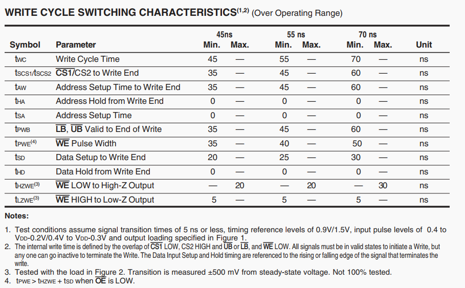

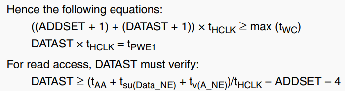

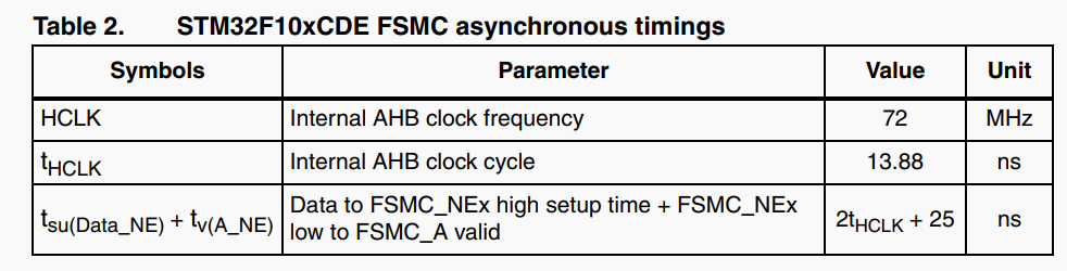

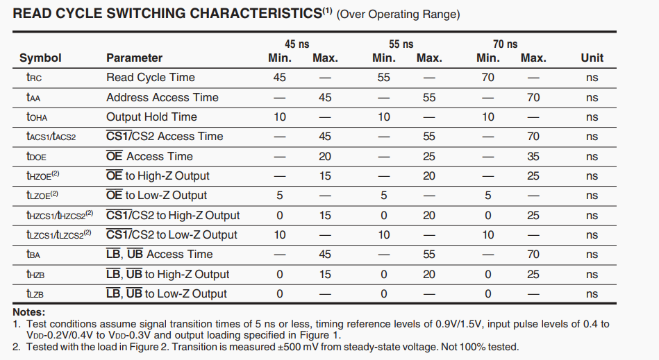

I use FSMC in STM32F407 to access external SRAM IS62WV51216. I read RM0090 and AN2784, gives me two fomula
tSU means

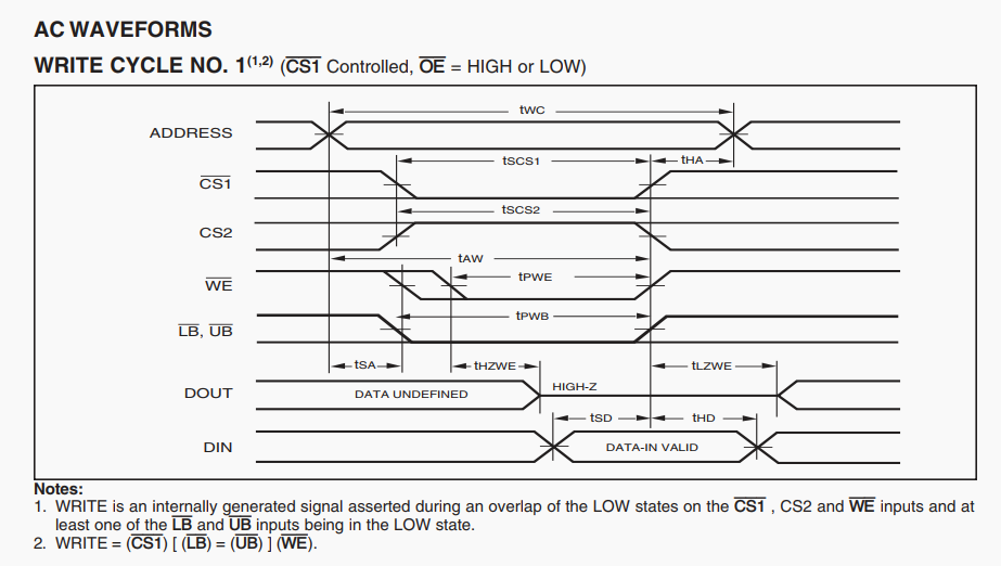

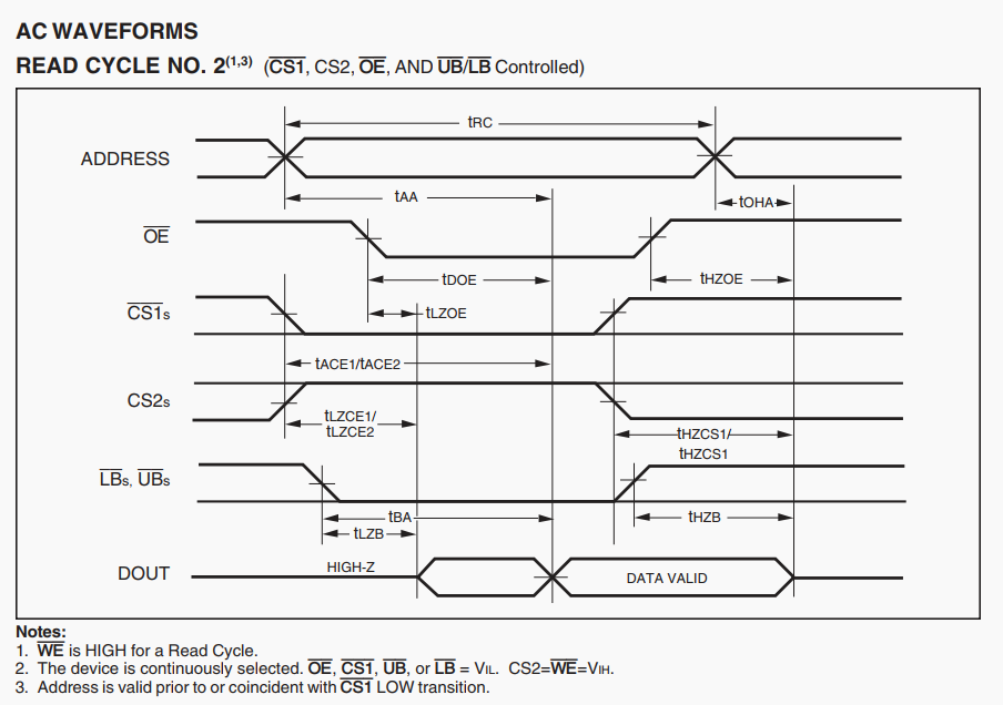

here is the timing graph
here is write timing graph
